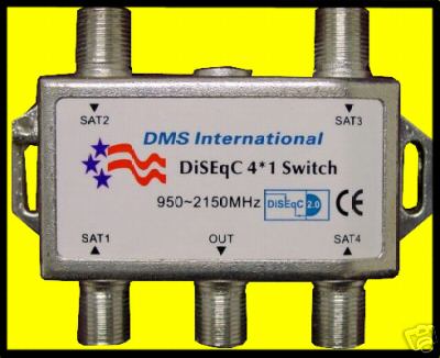

Gold Member Username: TapemanNew York City in-HD, NY Post Number: 1497 Registered: Oct-06 | All yo need is an LNB that has 2 outlets Called Dual Circular LNB ($15 off e-bay) 1 Coaxial input to each receiver Yo can't use splitters or yo'll have polarity problems just like what is going on now. Circular for 61.5/82/91/110/119,148 with 20" dish Linear for 97/121 with 30" dish ![]() If yo have Multiple Satellites and would like to use both receivers then Yo need a DISEqC switch. It looks like a 4 input splitter but the right kind for high frequency required for satellites ![]() 2 DISEqC (1 for each receiver) Also required to match each input to each LNB of satellite respectively. Along with simple antenna setup. |
