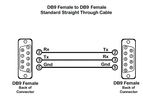

Take a look at the notes that should be on the same disk as the driver for that adapter, the software will assign a predefined com port to it, check what port number is assigned by the software and select the same in the loader...
If you get the "processing" message that means that you are selecting the right com port but it is better to get sure about it reading the notes, also check the cable that you are using, you need a RS232 Straight through cable, it should have this configuration:
