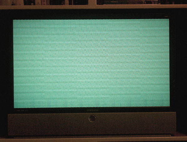

I unplugged it again, and then let it sit overnight. The next time I plugged it in, I would get no video at all, in fact all that I got was a pattern of small rectangular bars, each about 3/16" high by about 3/4" long, and running in a pattern of grays, light to dark to light to dark, etc.The pattern itself was static, it never moved or changed. I let the TV sit like this for a while, pondering my options, and then video kicked on like nothing ever happened! It froze up again soon after.
Now, whenever I turn on the TV i only get the gray pattern. Occasionally, it will flip over to the video source (whatever it is, i've tried them all), but after a few seconds to a few moments, the image will freeze and will generally stay that way until I turn it off. More often than not, I'll only get the gray screen of death.

Here is a picture of the screen>.<
Username: Skullkyng
Alexandria, VA USA
Registered: Apr-07
Edit: The above picture is not from "MY" TV but the screen pattern is identical.
