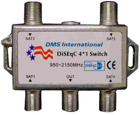

If they ground metal case they won't blow it
But it is true some transformers inside case use very thin wires
can't handle higher than 250mA to 300mA
14v/75 ohms=200mA
18v/75 ohms=240mA
In Many cases recivers left on horizontal transponder uses 18v can be very close to 250mA
If metal case is properly grounded it won't spike exceeding 240mA
Grounding case is best precaution
And good weather proof connectors
That DMS is a good weather resistant
But just like anything else higher quality is higher price
