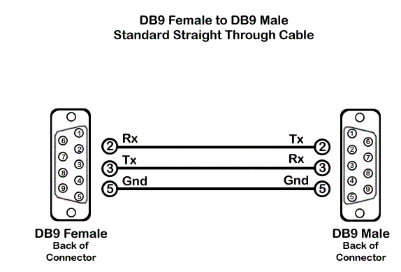

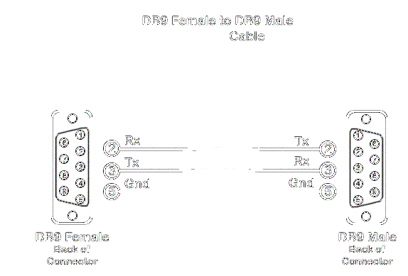

The Pansat 2500 (straight cable) and 3500 (null cable) use different cables BUT radio shack sells a cheap adapter that when added to the straight cable it converts it to a null modem cable..
Want to know what cable you need to flash that shiny,new receiver ? There are two types of cables used, and both look the same on the outside, but are wired differently internally. They are the straight DB9 RS232 female to female cable, and the Null 9 pin RS232 female to female cable. The straight DB9 cable has all pins connected the same at both ends(pin 1-1, 2-2,3-3,etc.). The Null cable(also known as a Null-Modem) has pins 2 and 3 crossed(pin 2-3, 3-2). You can use a straight DB9 cable to program receivers requiring a Null cable, by purchasing an inexpensive Null adapter to attach to one end of the straight DB9 cable. This allows one cable to be used for any receiver.

Username: Nikk
Post Number: 1364
Another thing.....
I was the one who originally posted those images related to the cable configuration....at that time there was a mistake on the null modem image, if you can see it says Female to Male...
The right one is Female to Female....that was corrected a couple of weeks after the first publication......
