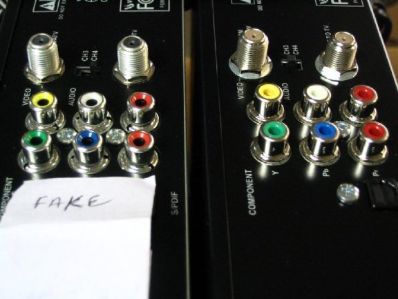

The RCA Connectors in the back of the unit , the colored plastic center are flat.

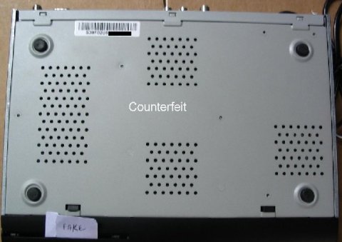

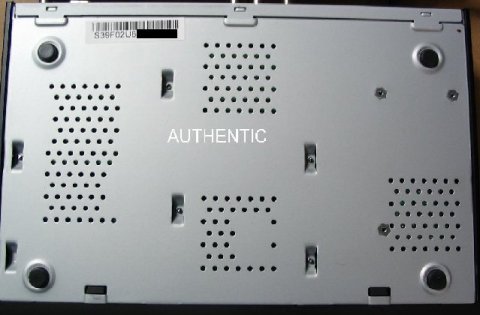

The underside of the unit, the plate that supports the PC Boards has six places where the metal is pressed and shaped to be used as threaded stand offs.
There are three silver hex nuts press fit in the plate
Also on the plate, in the cluster of air holes located in the center towards the face, there's an area void of holes.

The RCA Connectors in the back of the unit , the colored plastic center are beveled.

The underside of the unit, the plate that supports the PC Boards is flat.
The three silver hex nuts press fit in the plate are not present.
Also on the plate, inside the cluster of air holes located in the center towards the face,
holes are located where there supposed to be no holes

there are other differences such as the AC power cable made by a different supplier ( also text is larger than original) and there is a space gap where the AC connector goes into the receiver on the fake. The RCA video/audio cable -- color slightly darker on the fake and the six circular grip ridges on the original is replaced by oval grip patches.
