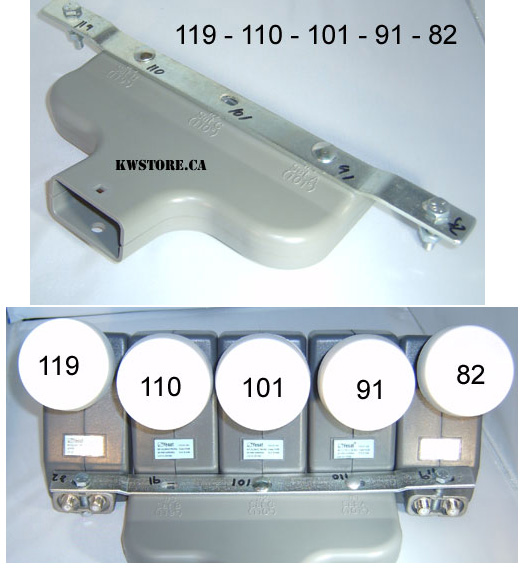

I want Dishnet 119 and 110. I want Bell. I want International Stations.
1. Can I have all of these stations on 1 dish using a bracket holder?
2. Will all the signals come in clear?
There is a store in kitchener ontario with hardware for all my needs. http://www.kwstore.ca/
When I called them they gave me a little bit of information, but then said they were too busy to answer all my questions and hung up on me.
I was wondering if anyone currently has a bracket on their dish and if you get all these channels that I want?
here is the website with the pictures of the 5 LNBF Holder.
http://www.kwstore.ca/product_info.php?cPath=68&products_id=998

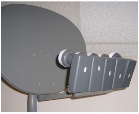

Username: Tapeman
Post Number: 588
I personally never tried it
But this is the kind of stuff I like to test
My guess it may work with a phase 3 DTV
by replacing middle LNB and add 2 extra LNBs on each side
Or perhaps a 35" super dish
Your Sat aiming and elevation/skew MUST BE BULLS EYE
NOT FOR A NUBIE more for an expert installer
a lot of trial and errors (sat finder, install/setup 1 at a time)

So i'm taking it king tapeman, you havent tried this before.. im just curious.
i know i have seen a 119 and 110 bracket on a dishs in my area before. im pretty sure i can do this. my friend who got me into this stuff says he's even taped 2 lmbf's together to get the 110+119 on 1 dish.
i was just hoping i can get
119+110+bell OR
119+110+international channels
thats the BIG question i want to know. :-)

Username: Tapeman
Post Number: 596
I don't think you'll find more than 1 or 2 people tried it
Most people will give-up 101 or 82
If you got 2 outlet of your LNB and 2 receivers
You'll do 4 sats on DISEqC and other selctive 4 on another DISEqC
You can tape or strap LNBs as long as they are pointed to reflected dish
See "King's Corner"
Post 138
https://www.ecoustics.com/electronics/forum/home-video/322149.html
Also Post 354 and 355
https://www.ecoustics.com/electronics/forum/home-video/300311.html

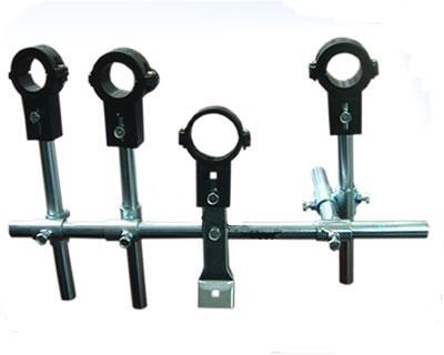

Username: Letmeon
Post Number: 137
Saw this assembly. I guess it gives better adjustment of the LNBs. Could be used on any satellite combo (almost), they have to be near each other. LNBs are adjustable in all axis .Upload
