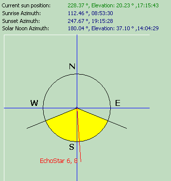

If you have a compass, your dish must point around 173° and declination must be around 28°, just get a compass and without touching anything just stand in fron of your dish and see if it is pointing to the direction of the following pic..

As Nalin said, you must be pointing to AMC16 sat, if you check the image I have posted just at the beginning of the thread it tells you the direction your dish has to point for Echo 8.10....you only need a compass or a visual reference about North and South at the location you are....

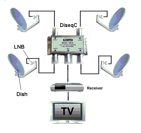

Username: Nikk

Username: Nikk
Post Number: 1050
sohaib.....
Te diagram shows every part you must have in your installation, after that you have to do what Nalin is saying in his last post here, set your dish declination to 28°, if you take a look at the back side of the dish it must have a scale graduated in degrees, you have first to move the dish the amount that Nalin says, then set declination at 28° or wherever you get the higher signal level....
