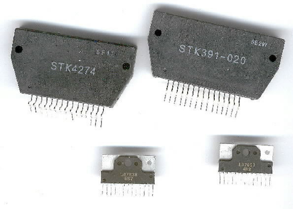

First check the main board for cold solder. Next replace all of your convergence output ICs. 2 or 3 depending on the set. They should be STK-series (STK-4273 or STK-4274, or STK-?, etc..). When replacing the STKs check for 100mfd 50v coupling caps that are leaking. Next check to see if the vertical output IC has failed, Should be LA-series (LA-7835, or LA7836, or 37 or 38) If the part# looks burned off the IC, replace all vert caps, 10mfd 25v, 2.2mfd 50v, 100mfd 50v. UNPLUG ALL CRT DRIVER BOARDS WHILE WORKING ON THE SET. The reason the protection circuit shuts down the set is "NO Deflection" will burn the phosphorus off the crt from high beam current with no sweep.

con and vert ICs

I will give it a try this weekend. The pictures are very helpful!
