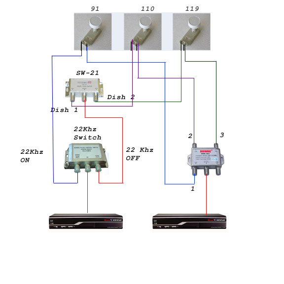

Right now i have 3 dishes connected with a diseq switch leading into my house.
i want to install a new receiver on another tv, my qustion is is there a way that i can't spit the cable in my house so that it then leads to 2 receivers. if so how can i do this and is there any downsides like quality loss or signal loss.
in other words wat i want is only one wire leading into my house then using some other switch that will split the cable in two so i can connect 2 different receivers on 2 diferent tvs.
thanks alot for ur info.
Username: Asharfi
Post Number: 367
You need another diseq switch. Yes, the second wire will also come through your house.

Username: Goat_skin
Post Number: 8
HC QUESTION DOES SW21 SWITCH WORK ON PANSAT 2700A? AND WHY U NEED 3 SWITCH?
I THING ALL U NEED IS 2 SWITCH MAYBE I AM WRONG
