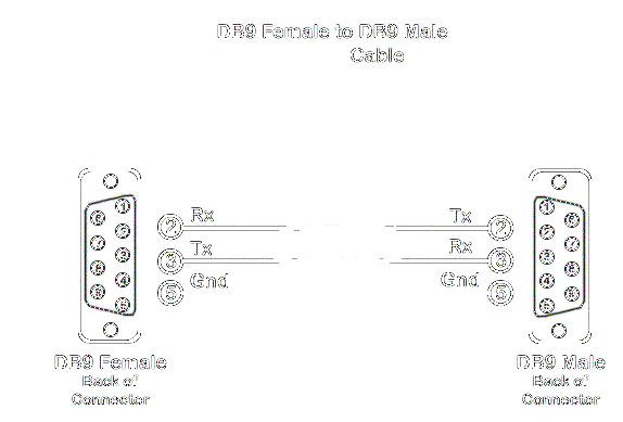

Username: Nikk
Post Number: 689
Both cables are RS232 but change on teh way the pins are connected through, RS232 Straight have the pins cabled 1 to 1 and RS232 Null Modem have the pins 2&3 crossed on each side of the cable...

It is not matter about if the cable fits....the connector is the same, the thing that change is the internal configuration of the cable......
Username: Nikk
Post Number: 695
The port at the back is DB9 for all of them, the internal cable configuration is the one that changes, that makes the difference, when I say that uses a different cable I don not mean that the cable has a different kind of connector, on the outside the connector is the same for all of the cables, but inside the cable they are wired different......
Username: Nikk
Post Number: 696
