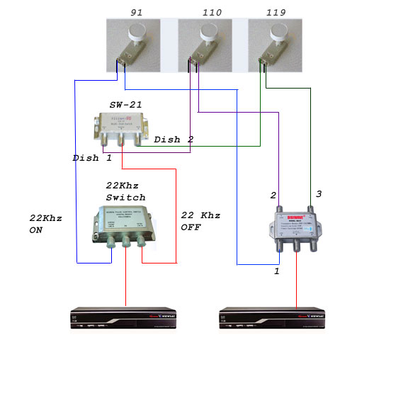

ok i want to add a second receiver to an 18 x 24 elliptical antenna with two dual lnb`s.
currently im using one output per lnb only and i dont have diseqc 4x2 switch, i have the two 4x1`s.
at one of the fta seller sites i saw a diagram where a 4x1 is shown after a 4x2, but it only looks logical that you can use ur 2 outputs with to different 4x1 alone.
also somewhere else i read that lnb frequencies get jammed with 2 receivers from one antenna.
any help and advice is greatly appreciated

Lk post this long time ago might help.
Username: Pukka
Post Number: 128
well thats with extra switches too, i thought it could be done with 2 4x1, this one looks a little more complicated.
thanks
Username: Pukka
Post Number: 129
got it!! , this is helpful at dsscomunity
