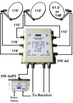

Here is how my current setup isUpload
Username: Tj_maisuria
All the right hands inputs are connect but only three output are connected to the three receiver. so, can I connect the Pansat 2700A to that port and will it work?
Thanks

Tony - If it's connected the way you have it in the diagram then connect the Pansat to the switch and configure the antenas as follows:
LNB = Standard
Freq. = 11250
The only other thing that would change is as follows:
110 DiSeCQ = #1
119 DiSeCQ = #2
65 DiSeCQ = #3
You should have no problems.

Also, you will need the power inserter for your fourth reciever. you can try it without, but I've read you need it.
Username: Prfrmnj
Post Number: 801
Jason is correct. Without the power insert it will not work. To much drain on the little power supplied by the receivers to the LNB's. It's an absolute must to use the power insert.
