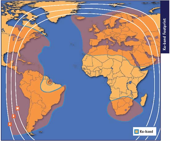

Username: Tapeman
Post Number: 46
Kavin this is just an example
Reading foot print can save several hours
So take a look at this, I'm still new at this and I'm runing to across few problems like Diseqc switches.
Hispasat 1C at 30.0°W
Germantown MD
North Latt'd 39°
West Latt'd 72°
Azimuth 120°
Elevation 24°
Most imprtant thing is elevation 24° which is easy to getUpload
Username: Tapeman
Post Number: 48
Telstar 12 at 15.0°W
Germantown MD
North Latt'd 39°
West Latt'd 77°
Azimuth 108°
Elevation 13°
This is all one spot beam reachable to East coast of N. America
Username: Crazy_greek
Post Number: 157
Very nice
The dots with red numbers?
To hit a lot of birds in our foot print you need a large Dish,but you also need to clear the elevation to the satellite.
Like I said the best I can do is 27.5W Intelsat 907. Too many buildings & trees.
BTW Hispasat1C @30.oW has alot of channels.
Username: Tapeman
Post Number: 49
- White Circles reperesent boundries mostly elevations. i.e. someone in Calfornia will not reach because the elevation is in the negative so the dish has to face the ground.
- Hispasat 1C at 30.0°W small red circles represent signal strength in (db)
- Telestar 12 at 15.0°W Shaded area with blue, for Ku-band reperesent reachable area but they didn't put values
- YES you can only get with large dish
- I have 2-Linear LNB NF: 0.3 db 2-Linear LNB + a third one Circular but I dindn't get lower SATs but I never give up.
You can get from www-wsidigital-com or www-centronics-com I think they are in Maryland
But they were no help I had to do things on my own
Just wait until all leavs fall. trees can block signal but they won't trap it
-Are you trying to add a SAT that is not on the list? (let me know )
