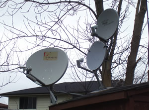

I have three individual dishes that are mounted on top of a wooden garage. The first two are BEV dishes and the third (pointed at 97) is a Starband dish (75cm eliptical), which has a linear LNB. Individually everything works.

Not that it matters, but here are my dishes:
I am looking for a multi LNB holder for the Starband Dish so I can get rid of the transmitter and the other dishes (18 and 20").

According to the photo it looks like each dish is pointing to same SAT. you need 1 LNB for each SAT Why don't start with the following:
- One dish 2 LNBs pointing to (82) to get both BEV 82 and 91.
- Second dish with 2 or 3 LNBs you can get 110, 119 pointed to (119)
- Third dish to 97
-You can even do a lot more with these 3 dishes
Just keep in mind one LNB for each SAT
Why don't you start with 82, 91
Previously you said you got each SAT seperatly what I think was happening is all along you were getting 119 even if there is a signal on 82, 91, 110, 119. SIGNAL DOES NOT MEAN YOU GOT THE CHANNELS.
- So put 2 LNBs strapped together with a tie wrap or get a bracket that holds two LNBs to get 2 SATs with one dish, start by moving one of YOUR dishes about 15 degrees twoards east and away from 119 to get the CENTER OF CORRECT BEAM
-Set one SAT to port-1 and the other to port-2
Do Blind scan followed by Channel Scan
You have to make sure you get correct channels before you step and repeat to other SATs
Your DISEqC switch sounds fine but limited to 4 SATs. Hold on to your TEREK antenna IT can go straight to your TV tuner get your HD if that is what it is for.

The dishes are pointed in different directions, the picture is taken from below and on a bit of an angle, but I agree - it does look like they are all pointed in the same direction, but they are not. If you look at the feed arms, you can see how they are off center from the middle of the reflectors, it is also hard to judge the size of the dishes as they are stagered in distance as well, the midle is the closest, the top is 2nd furthest and the starband dish is actually back a couple of feet. The picture makes the top two dishes look like they are the same size, and the starband not being much bigger even though it really does dwarf the other 2 dishes. The 20" BEV dish has a dual LNB holder on it, but I have only one LNB installed - it also looks like it is on the tree, but that's another feild of depth issue - the tree is a few meters behind it. The yellow house is actually pretty far back as well as they have a large swimming pool, but you would never know it from this picture.
The top (20" BEV dish) is pointed at 119, the 18" dish is pointed at 82, and the Starband is aimed at 97. They all work individually on the chosen sats, and I do get all of the channels individually (except 97 - as I only get the horizontal due to the current LNB setup)
I intend to get rid of the top two dishes completely, and just use the 30" eliptical dish with 4 LNB's, but I will have to modify the feedarm a bit first. This is just a dry run.

- I really do think your dishes need to be re-aligned I can clearly see they are pointing to 119 (Trust me)
- Your Starband 30" is also pointing to 110

I am 100% positive that my dishes are pointed correctly as I get all of my channels individually without the diseqc switch, otherwise it would not work at all.
I'll get out there and take another pic tomorrow from a better angle.
