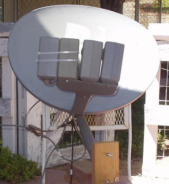

Like this.
C/P
the leftmost LNB is for BellExpressView on Nimiq 1 at 91 degrees west, 2nd from left is for Direct-Tv at 101 degrees west, 3rd from left is for Echo Star 6 and 8, at 110 degrees west, and last, or far right, is for Echo Star 7 at 119 degrees west

That looks more like L-R..82,91,110,119..all Bev and DN...there's too much spread in pic to be 101-110 (9 degrees)...that pic is 91-110 (19 degrees)...the middle 2 LNB's..

you can actually get both bevs and dn's in one satelite?? but four lnb's? ive been trying for months now to get both dn's on one satelite and i can only get one at a time with an sw21 switch, how is that possable?
Username: Lklives
Post Number: 5318
with larger 30 inch dish, its very possible to get 4 LNB's..on small dish, its easy to get DN and Bev using 2 LNB's..

yup, I have 2 18" poormans dishes, 1 for 110/119, 1 for 91/82. Use a diseq switch and ya got 1145 channels :-)

L-R..82,91,110,119 would look something like this but this is not possible.
