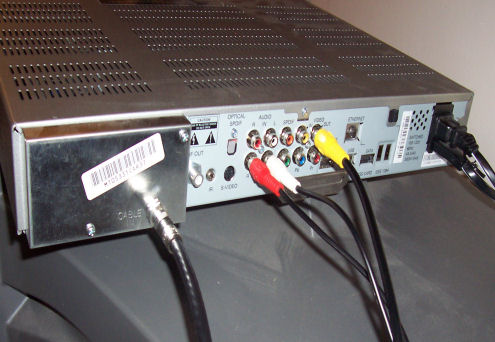

comcast DVR Box and this connected to my tv through the video out on the Cable box:

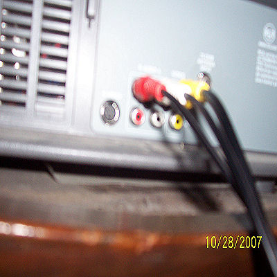

Then to the video in on the tv:

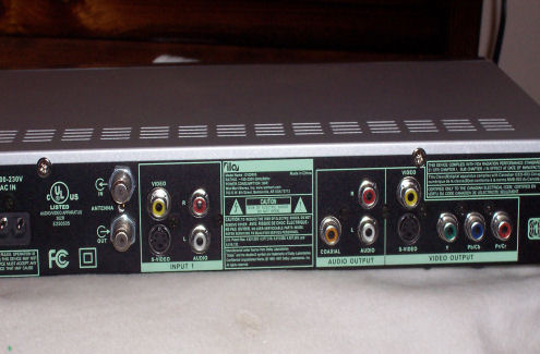

My Question is how do I hook up the DVD-Recorder- Pictured Here:

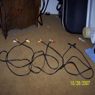

I have several more cables other than the ones in this picture as well..but I believe that these were the ones used when it was hooked up correctly( Except the S-video cable)

From the pictures the progression is:
Audio and Video outputs to Audio and Video Inputs on the DVD Recorder and then Audio and Video Outputs of the DVD Recorder to the Audio and Video Inputs of the TV. Of course, you will only be able to record and watch whatever is playing from the DVR Comcast box unless the DVD Recorder allows pass through if it is turned off. Very few do (the Polaroid 2100G does). My Liteons and Panasonic do not allow this. Everything must be "live" for things to work....
