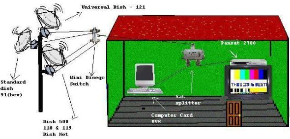

Username: Ryersonresurrected
Post Number: 107
Hi bui,
Sorry about that - i tend to do a lot of short form writing (tried to avoid it in the post because of the obvious conclusion, but force of habbit got to me)
* Yes, i meant "to"
* No, not a DVD card, it's a DVB card (FTA satellite card by Hauppauge)
Let me see if i can explain better:
i only have one cable coming into the house. It originates from a Dish 500 (110/119), and two other dishes (one is universal dish pointed at 121, the other at Nimiq 1).
They are all connected to a diseqc switch.
The cable running into the house is the (often times) split in two (i know i shouldn't, but it works sometimes, and i can always remove splitter when needed - i should really get an A/B switch soon, just haven't decided on permanency yet).
Split: one line goes to pansat 2700,the other goes to my pc DVB Sat card.
If I'm trying to pull off an impossible, that would be great to know. I'll decide whether the inconveniences are worth the hassle or not, i guess). But if it IS possible to do this better another way, that would be great to learn as well.
Maybe the A/B switch would work best, is this the only reasonable/possible alternative?
Thanx
Username: Tadon
Dover, NJ Usa
Post Number: 124
Hi Ryerson,
Let me repeat what you need . If I am wrong please correct . So you have :
1. 4 inputs (110/119 & 121/91 (?) )
2. 3 outputs (1 Receiver & 2 PC) . But only permit 1 cable run into the house then you will be split signal out (from 1 cable) to 3 outputs.
you want like this ?
buile
Post Number: 127
Does this make sense: Upload
Username: Tadon
Dover, NJ Usa
Post Number: 125
I don't think it works . I surrender :-))
Maybe experts in this forum will help you .
But if you want to try, just do experiment, I don't know it will work or not .
you can use 3 diplexers (cascade connect) to combine
4 signals to one (1) cable go into your house . Then inside your house,
you use 3 other diplexers to open back 4 signals .
Then you connect 4 signal with 3 or 2 diseqc (depend on how much output
you need). So you will get 3 or 2 outputs connect receivers/PC . hope it works :-))
Have fun in weekend
