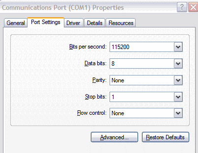

Username: Jenifer_contreras
Tampa, Florida USA
Post Number: 352
I got XP Professional,it was a problem with speed setting on COM PORT,after correction no problem, flow very smooth!
Tampa, Florida USA
Post Number: 353
Ouchi Collashi, the default settings always like this:
try to click ''restore default'',you will see !
Tampa, Florida USA
Post Number: 354
Look bane j! if you say your FLU only flashes with Microsoft Windows XP HOME,so then do this...
1.On both comps open Com. Port Properties and make XP PRO setting the same as XP Home...it should work 100%.

Many people have had this problem..it is not a come on..Jennifer is right, about the default and needed settings..
