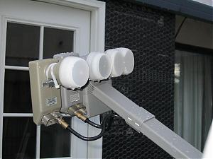

well thats NOT exactly true...depends upon the size of your dish and location..heres proof with the pic..
[link removed]
I changed my setup yesterday from 2 Legacy 18" dishes with the LNB "cheater" brackets to a 24x18 with a 5 LNB bracket.
I'm currently pulling in (left to right) 82,91,110,119 all 90%+ signal. I still have room if I choose to test 101 I'm surprised I'm pulling in 40 degrees worth of horizon with such a small dish I figured I would have needed a t90 or similar.
