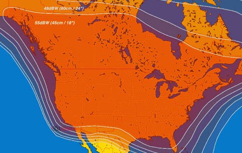

Username: Qwerty43
Post Number: 12
Rob, I tried to use the satelite calculator you listed above, but it keeps telling me it can not calculate that satelite. It says it is for north west hemisphere only. Any suggestions?
Username: The_wank_artist
Post Number: 1268
jason: Make sure you have the correct keys in place for provider 0901.
kelly: If you're hitting 82, you need to be roughly an lnb's width to the right (facing behind the dish)
qwerty43: It depends where you live and you need to be in the following footprint (see image)
