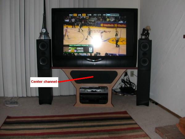

I noticed a broken lense/glass in that opening. I am hoping that this is part of the light engine. Could you verify this.
Doog,
The lamp itself has a flat glass face. There is also a lense (for a lack of a better word) that has I beleive a reddish coating right AFTER the lamp, but before the "turn" the light makes to go down the light tunnel to the light engine.
The piece I'm thinking about is right where the words "Lamp Unit" are in the picture.

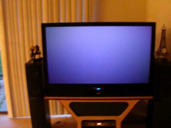

I'm another long-time "lurker"...posted on the lamp thread about that failure earlier this month (52z585, bought in June '05).
Now, the dreaded "no red". Tech. came today and confirmed light engine problem. He says it's likely a firmware issue rather than a physical problem, and that code is so protected no Techs can fix. He says a week for the part (I hope doog is wrong!).
His shop has replaced about 15 here in Salem, OR. He knows from JVC Tech. classes that JVC is invested in fixing inherent problems like this. I can only hope that before the extended warranty runs out (4 more yrs.), they get these glitches figured out.

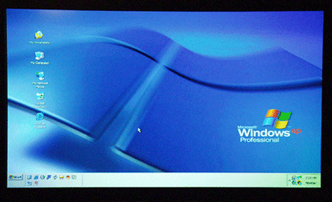

Finally got the HTPC working with no over scan.
Will try to post a few screen shots soon.
I wasnt able to find the correct setting in Powerstrip, but since I was using an nVidia diplay (DVI-D to HDMI) I was able to make adjustments through the video properties control panel.
Basic settings were;
Resolution 1152x664
HFP 112, HSW 40, HBP 344, 44.96 kHz
VHP 5, VSW 5, VBP 76, 59.943 Hz
Screen Refresh @ 75 Hz
Picture Quality looks great!

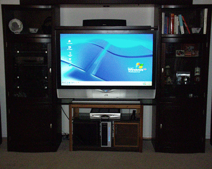

here are a couple fotos, the digital camera isnt very good in low light, but can get the idea. The pc is on the bottom shelf, below the cable box.

Reloading Photos
Here is a screen shot. The digital camera doesnt do too well in low light.

System photo
The pc is on the bottom shelf.

Nice setup and good pics. I really need to finish building my HTPC. I've used my current PC with my TV, but since we use it a lot for business matters the living isn't a good spot for it.

Mr. Lynch,
How do you have your center channel mounted above your HDILA? I haven't been able to find anything that will accommodate the shart drop off angle of the back of my 52Z585.

Just a quick review; I'd seen someone post about hooking up a computer to the 575 series, used PowerStrip to set 1280x664 (or something close) to eliminate overscan, but what refresh rate? I'll be using an ATI X800XT, hope to get it working with a DVI-HDMI cable.

My Center channel speaker is mounted BELOW my set. I custom built my own TV stand.
Username: Shawn_murphy
Mr. Lynch - sorry, I was looking at Wesley Dwight's system picture and your post was directly below it. Nice system.
Wesley Dwight - how do you have your center channel speaker mounted above your HDILA?

Username: Wes_dwight
Poway, CA United States
Shawn - the center channel spkr is actualy on the top shelf of the wall unit. Ive seen a few posts where people have fabricated a stand that uses velcro to attach to the set to place the speaker on.

Tim Bowser - My settings were posted at https://www.ecoustics.com/cgi-bin/bbs/show.pl?tpc=2&post=600195#POST600195
Yours will probably be different with the ATI card, but 1280x664 will be a good start. The screen refresh should be 75 MHz
Search 'Powerstrip' through the forum and Google and you'll come up with alot of advice.
The DVI-HDMI cable Im using is working great, just make sure the DVI port on your ATI card is a DVI-D port (not a DVI-I port, all reports suggest the DVI-I connection doesnt work with the JVC)

Greetings, I recently purchased the HD56G786 unit, new. It has a slight blue cast in the top left corner, a green hue in the
top right corner, and one dead blue pixel in the dead center. Otherwise the picture is excellent.
The date of manufacture is November, 2005.

Robert-
JVC will generally replace/repair your TV if you have a dead/stuck pixel in the middle of the screen. The color problems in the corners also sound like a bad light engine. I'd call a local tech and have him look at it. Does you screen look anything like this?
BAd light engine, green in the upper left, blue/purple in lower right.
New light engine- nice uniform color.

Mr. Lynch, Thanks for the reply. My picture color distortions aren't nearly as pronounced as your photos, but as I now have seen them, I tend to look for them. I am tending toward keeping the set and ignoring the problem. Also, BB told me they have a program that will reset stuck pixels. I did not get the chance to see if it works for Lcos, they have used it on a plasma. All in all I am satisfied. Since I probably am going to keep the set, I thought I would ask you for the service manual.
Thanks again.
