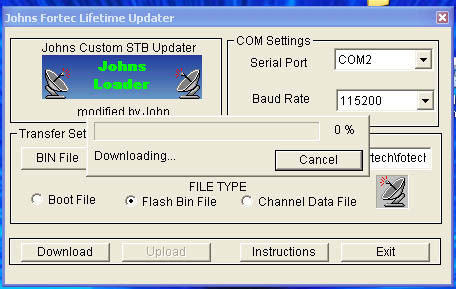

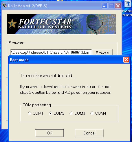

Ok i have db9 cable wich i 'm using it for my pansat 2500a clone. i have no problems on that.
I don't know if is null modem cable it worked on my clone.
For my fortech star lifetime classic na, I'm trying
1.DnUpMan_060414
2.Johns STB Updater Application
with ''LT Classic NA_060613.bin''
I'm getting message "WAITING FOR THE RESPONSE OF YOU RECIEVER"
take a look at my picture i

Here is other loader!!
Username: Gunaa
Post Number: 48
PLease help me!!!

Gunna I am almost positive you need a null cable (crossover) cable. I think the one you have is straight, and unfortunatelly there is no way to tell by just looking at them. But for sure you need to use dnupman instead of the other loader. I would suggest first checking that your COM ports are properly installed and then if they are (check in System, from Control Panel) i think your best bet is to buy a null modem cable, they're relatively cheap.

Thank you J Dawg!!
I'm going to buy that cable today and try it.

and also you was right on null crossover cable!!!
