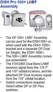

Post Number: 3102
Here is the DN LNB...
Username: Boyce
Post Number: 231
Registered: Apr-06
I know, those are DPP. Hate it.
I found this one, http://www.futurevisionsat.com/catalog/item/691952/1783375.htm#image_1
