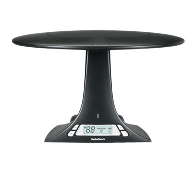

Username: Blackolds98
Registered: Mar-05
I am also new to the HD game...currently have a 51" Sony projection and HDTV receiver thru DirecTv. I recently purchased an off air antenna (Radioshack amplified Indoor VHF/UHF/HDTV #15-1892) and don't get jack. I don't know if I have it hooked up right, but it's pretty brainless. Do I have to go to a special channel through my HD receiver? Do I hook the antennas "TV" to the VHF/UHF connection on my tv, or the AUX? Are there any special settings??? Please help this frusterated newbie!!!Upload
