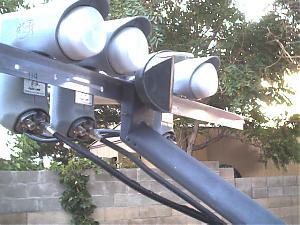

heres a homemade 4 LNB dish with 121-119-110-91 sats..and can add 82W if U want a 5th...remember the 121 is a linear LNB, rest are all circular..

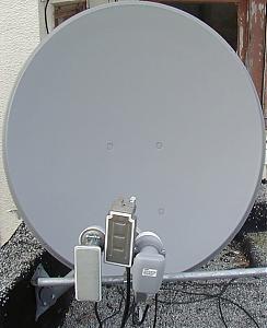

BTW...this is with a 30 inch dish..and heres' another with 121 on arm with 119 and 110 or 91..be creative
Making your own DN Super Dish (110,119,121)
Hello All, I finally made some time to take some pictures of the superdish that i have made and would like to share with you all. I used one ku-linear Lnb and two DN circular Lnb with dual ports. The dish is a fortec star 30" ( 80cm ) dish , I mounted the ku-linear Lnb to the dish arm and mounted a 1/2" emt conduit pipe 6" long. I located and locked onto sat 121 with the highest quality possible and mounted the circular DN Lnb for 119 to the right of 121 ( looking at it from behind the dish ) and then mounted the circular DN 110 Lnb to the right of 119. The hardware is used from any electrical suppy store. The brackets that hold the Lnbs are from 1/2" to 2" emt pipe clamps/brackets. With this kind of setup you can get 4 axes points adjustments: forwards/backwards , up/down , left/right , side to side.

U have a picture of the dish right in front of U!!!...are U serious!..BOTH posts get 121 ,110 and 91...2nd post the guy just removed the 91...as U can see there is plenty room for more LNB's..large dishes are round...I can't beleive U are even asking this!...especially when pics are provided!....sound like U are getting into something over your head, if asking more questions and not believing pictures and posts from actual do'ers!!
