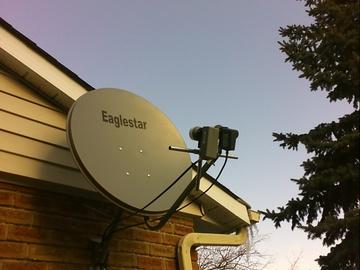

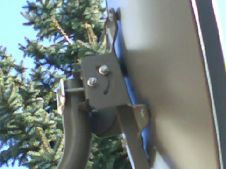

hey guys this is the dish i have i'm trying to get 121 119 110 on it, the problem is i cant find 121 or 119 the lnb for 121 is a linear an as u c in this picture it's attach directly to the arm as 119 and 110 are on the extenion pipe my dish is 33inches and it does not have no skew but i can skew the lnb's with the instructions i have it said to first find the 121 bird but the only signal that i got give me about 44 channels that the picture wasnt showing to clear, i check these channels on lyngsat but couldnt find what bird their on here are the tp's and channels 12283h,11709v,11814,11861v,11894,12238v espnd,diy,cnbcw,tmndo,real,cnbcw,cstv,flvng. i would like to know if i should put all 3 lnb's on the extention pipe and none on the disharm and which bird i should try to find first and which lnb i would need to skew.

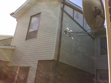

the only coax cable u should use for satilite is rg6 thats to begin with, as for setting up my superdish i didnt as yet cuz i was doing research but now i thing i have gotten all the info, my first downfall was using a fta box trying to find the signal, u need to use a dishnet reciever as for the rest i will let u know 2morrow here are some pic's what my setup looks like, my main problem was trying to skew my dish because it doesnt have any i can only skew the lnb.Upload

Thanks for the replies. I bought superdish121 with DP34 switch from ebay. I have Pansat2700A receiver. We install the dish on an iron rod digged into the ground. We have set the lnbs on DP34 switch as 110 to 1, 119 to 2, 121 to 3. After adjusting the dish we got signal and 90%quality from 110. But we are getting 70%signal from both 119 and 121 but no quality. We are getting local channels and payperview channels from 110 but not all the channels like Nicklodean,HBO comedy etc. Actually I am not sure which cable I am having RG59 or RG6. I am getting the signal for 110 so do u think I still have to change the cable? I will send my dish photos in the next mail.

i wish i can tell u, but i was outside for hours today trying to still locate 121 i found 119 and 110 all channels work, if u look at my dish can u tell me if u think something is blocking me from getting 121, is your superdish in a clear location?
Username: Jnps116
Post Number: 9
I have the same situation like you. I have trees back side of my house too. I am thinking to take photos and send to you :-). One of my friends advised me to buy a satellite signal finder. I am going to buy that from ebay. But when I see ur photos(2nd one), it seems your house is blocking the dish.
Username: Lklives
Post Number: 890
It looks like a tree is in your line,but the photo is not well taken to determine..If U got the 119, then U should have the 121..thats only 2 degrees apart..many people inadvertently get the 119 and 121 together when aligning the 121 or 119..a sneeze move will align the 121 from the 1119..
