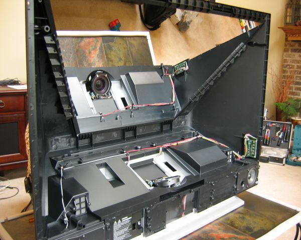

Here's a picture of the insides of a JVC D-ILA to give you an idea what the inside of a RP set looks like. Upload
