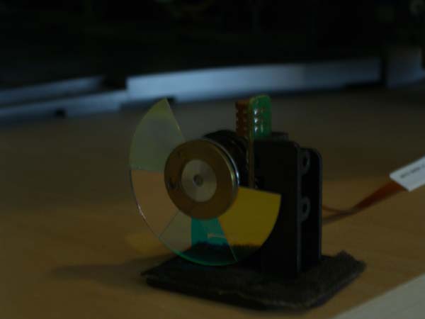

Had my 61in sammy for about 2 years. First 11 months the color wheel made noise, they replaced w/new type. A little more than a year later the color wheel is broken again. This time I was watching tv the other night and I heard a loud noise and then the chainsaw noise. At first I thought it was the bearings again. But when I looked closer half the color wheel segments are gone and broke into small pieces inside. I ordered a new one and I'm waiting for it, but what in the hell could have caused it to break apart?
Username: 31ratrod
Registered: Dec-05
Also there's a rubber type pad under the wheel that looks like it was rubbing on it a bit. I've got pics I can post if anyone wants to see em.

Username: 31ratrod
Registered: Dec-05

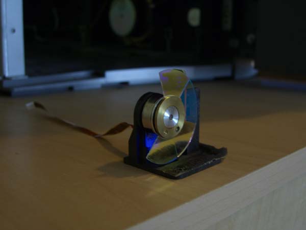

Here are some pics of the color wheel. I had already vacuumed up the pieces of it in the light engine.

Username: Fyi
Dallas, Texas
Post Number: 532
Registered: May-05
WOW!
So...do you suppose a wheel segment came loose and made contact with the rubber pad until it finally caught and took out some other segments?
Username: 31ratrod
Post Number: 7
Registered: Dec-05
That sounds likely. Or something freaky like a bug or clump of dust caught it just right, but I doubt it.
