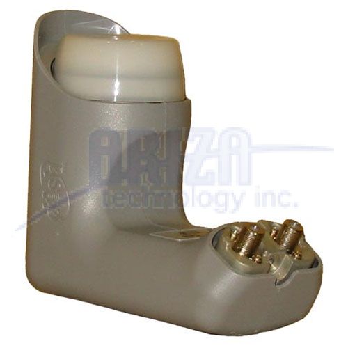

Assuming it is 2 dual lnbs and not a DP twin, you'll HAVE to use the diseq switch.
@Jane Lan
Is it 2 separate (dual) lnbs or one twin (2 lnbs in 1 casing)?
Dual:
DP Twin:

Remove ALL/BOTH cables from switch and run ONLY 1 cable direct to receiver..if BOTH 110-119 come in,then its a DP twin and no switch is needed..and the 2nd cable is intended for a 2nd receiver only
If it does not work, then its a bad disque switch and these are 2 single or dual LNB's..which was first reply because it was stated she was using a disque (implying single or duals) and DP or twin was never mentioned..and the implication was she had proper remote config

It is a dish 500 with 2 separate LNB's, NOT twin.
