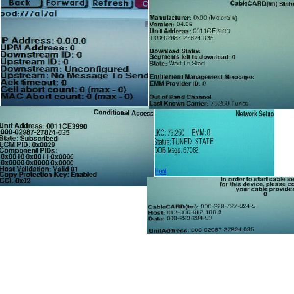

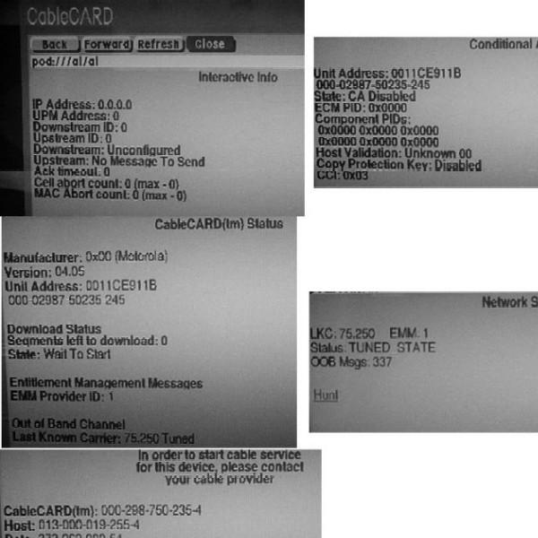

Bronze Member Username: CableguyDeep in the ... U.S. Post Number: 28 Registered: Mar-05 | Kdog, Do you have an HD STB? Does it work properly? I know you've been posting about your Toshiba issues since late March. If you are still unable to have success with Comcast, try calling Toshiba again and see if they can escalate this issue you are having with an engineer who works on this technology. I can't speak for Comcast because I don't work for them, but we have no problems with Toshiba's and CC's. Once the firmware is updated on the host television everything works fine. The 161-4 error code you saw before was an indication something wasn't doing what it was supposed to. What does your CC CP info screen say? Access that through the CC menu, you should have 3 items CP Info/CC Diagnostic/CC Info. Look at the decryption status and PowerKey status these two status items usually will tell you something like not ready waiting for xxxx. I don't know if this is true with the Motorola brand CC, if it's the SA it should. Just curious why it's still not working. |
Bronze Member Username: Kdog044Post Number: 73 Registered: Feb-05 | I checked with another user who has the same television and a different cable company and in comparing the menus the only one that looks different is the "conditional access" menu. In the "state" his says "subscribed" and mine says "CA disabled". The other two differences are the "host validation" and "copy protection key". His indicates "Valid 01" and "enabled". Mine says "Unknown 00" and "disabled". The only other difference I see is the EMM Provider ID but I don't know if this would matter or it's just different with different cable providers. I'm attaching my menus (black and white) and his (color). ![]() ![]() |
Bronze Member Username: Kdog044Post Number: 74 Registered: Feb-05 | To answer your other question, I do also have a STB. I have the Motorola DCT6412 and that works fine. |
Bronze Member Username: Kdog044Post Number: 75 Registered: Feb-05 | One last request is if you can explain what the different items are in the Conditional Access menu like Component PID's and ECM PID or any of the others I would appreciate it. |
Bronze Member Username: CableguyDeep in the ... U.S. Post Number: 30 Registered: Mar-05 | ECM's are a data unit that contains the key for decrypting the transmitted programs. A PID is a Proportional, Integral, Derivative and are designed to eliminate the need for continuous operator attention. In effect are kind of like cruise control for the data being sent, that has to fall within certain guidelines. As far as the other stuff...moan, only if I have to. Since your CC is Motorola I don't know what the specs are. I did see on one of the screens it has recieved ECM's which is a good thing but don't know why it stating different things on the same lines. For example one screen shows STATE: SUBSCRIBED, HAS ECM PIDs, Host Validation: Valid, and Copy Protection Key: Enabled ( lowest left screen photo) then (upper right screen photo) has different Host Address/State CA disabled etc etc.. The only thing I can offer is be very dilligent between the TV manufacturer and your Cable Company...you spent good money on the TV for the feature you can't use and demand answers. I've done enough in our system to know they work, and that's why I try to help. I wish there was an easy answer to what you're seeing and why it's not working but I can't tell from the screen shots because the same data screens have conflicting information. It's usually best when you're looking at the CP info screen to have put the TV on a digital channel ( even if it's not working) to see what data it is recieving. On the second screen photo (left side) very bottom is the OOB (out of band) info states last known carrier: 75.250 shows what frequency your cable co is putting out the data your cable card needs to gather it's information such as the ECM's and EMM, Decryption Authorization etc... the fact it saw the OOB carrier shows communication between the cable and the cable card. You have all the data you need to send back to the manufacturer and tell them to please explain why this thing isn't working. You really need a good escalation from the normal rep to somebody that is at minimal an engineer or tech to look at that data and tell you why. I'll be watching for any updates, sorry if I can't help...maybe if you move to our system I can get it working for you ? Hang in there |
Bronze Member Username: Kdog044Post Number: 76 Registered: Feb-05 | Cableguy, I thought I made the menus clear. The top five (black and white) are my menus where the card isn't working. The bottom five (color with blue background) are ones another poster sent me. His is working. I attached both of them so you could see the differences. Sorry if this confused you. |
Bronze Member Username: Kdog044Post Number: 77 Registered: Feb-05 | Well, I had Comcast back out today and still no resolution. They did find that my signal was too low (-7) and ended up adding an amplifier to my incoming feed but it didn't resolve my problem. The card still says "CA disabled", I still get the pop-up box indicating "acquiring channel information" and I can't tune to any channels with the cable card installed. Comcast said they've done all they can so I have to call Toshiba and see if I can get a technician to look into the problem. Does anyone know what the EMM Provider ID is? I know my DVR has a EMM Provider ID of 0X0003 (3?) and the cable card indicates 1. Should these be the same? The Comcast technician says the card is coded correctly but I have no way of knowing if this true. |
Bronze Member Username: CableguyDeep in the ... U.S. Post Number: 31 Registered: Mar-05 | Kdog, You are absolutely correct, you did clarify I just did a poor job of reading your post thoroughly. As far as the differences between the two, what he is seeing is exactly what you should be seeing. The EMM you are getting can vary depending on what channel you're viewing so don't judge by what your STB is telling you. The fact they they added a signal amplifier can be adding to the problem. Keywords "can be". If there is a problem with the signal being low to begin with, all the amplifier is doing at that point is amplifying a dirty feed. At this point, it is in your best interest to have Toshiba send a tech out to investigate. Not pointing fingers, but you could have an seperate issues that combined are causing your problem. The fact that the other user has a different provider then you do, only shows there's nothing wrong where he is, and not where you are. If you can find somebody in your area that also has the CC maybe you can compare better screen shots. I'm still interested in finding out what it is, cause I can learn from what you've been through. Don't give up without a fight, they work. |
