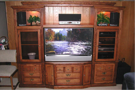

"187" ... Since you asked, this is for you! Here's a picture of our new Toshiba 44NHM84 that we got last week. This is an actual live picture (using the "freeze" mode)...
My wife and I couldn't be happier, but I think she likes the new entertainment center the most. ;) We're hooked-up to Comcast with their new HD/DVR box that allows us to record up to 60 hours of programming (like a TiVo). Still can't believe how awesome HD looks! In the Seattle area, we have around 13 HD channels, 90% of 'em being the ones we watch. In the 5 days since coming on-line, neither of us have seen the rainbow effect, although I did see them on a Samsung 46 during my TV shopping.
Overall, I am very pleased with my choice of the Toshiba 44NHM84. fyi

Thanks for the pic DMILL :-) Your entertainment center looks really slick !!!!

D-Mill where did you get that awesome Entertainment Centre?
Username: Dmill
Bellevue, WA
Registered: Jan-05
Ms S ... Got it at Levitz, of all places. It's their Cambridge unit. As I mentioned above, the TV stand is 41" wide, so the TV fits like it was custom made. We really like it, as does my wife.

D-Mill, How much did it cost?

Ms S ... The cost was $1299, but we got 10% off for NOT taking advantage of the "1-Year, No Interest" offer.

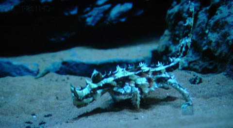

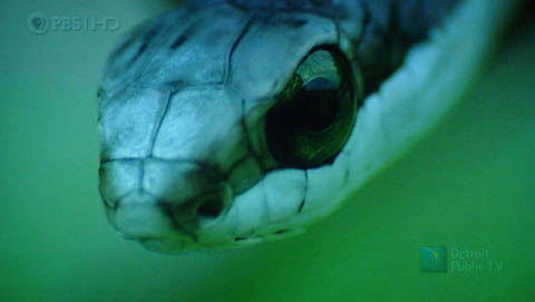

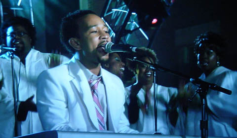

After reading about all these doubter's complaints. I felt like sharing some pictures of what my 44" dlp looks like after all the service menu adjustments from the good people of this forum. Thanks guys for fixing my TV. Mind you my digital camera sucks so these pictures look much better then they depict.
Username: Stinky
Toronto, Ontario Canada
Registered: Apr-05
Username: Stinky
Registered: Apr-05
Username: Stinky
Registered: Apr-05
