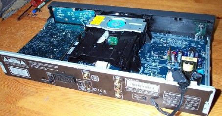

New member Username: DocdatCopenhagenDenmark Post Number: 9 Registered: Apr-04 | Hey John, great review. I think I just got my T760 working again, so instead of spending money on a new receiver I'll get a new DVD-player with DVD-A and SACD capability instead. ![]() I've listened to a lot of receivers the past few days, and I think the T760 can definitely hold it's own against even rather expensive current models, when it comes to stereo and clean power. The only weak point is the bit dated processing. But by using a high quality DVD-player with good built in decoders connected to the T760's pre-ins that isn't an issue. |
Silver Member Username: John_aPost Number: 630 Registered: Dec-03 | Thanks, Adam. How did you fix your T760? Mine delivers "all speakers large" DVD-A like it was built for it. No clipping, no sweat, and higher volumes without getting as hot as with the DVD-Video formats. I don't know why that is. "Ext 5.1" is like having stereo all round: more detail, cleaner, tighter sound. I suppose it is using just the power amp stages and the player is doing all the processing. For a combined DVD-A/SACD player there are some recommendations here for the Denon 2200 from informed guys like Kegger and Two Cents. However, where I am it is twice the price of the NAD T533. |
New member Username: DocdatCopenhagenDenmark Post Number: 10 Registered: Apr-04 | Well I'm not sure I did anything or if it's really fixed. Yesterday I took it apart again in frustration and still couldn't see anything wrong. I tried pushing a bit on the various connections, closed it again, meticulously attached only the center speaker wire before the others and tightened it as much as I could. Attached all the other wires, and started it up. Since then the center channel has been working. I don't understand it. Before this I tried different speaker cables and also banana plugs with no success. Anyway, I'm not complaining as long as it keeps working ![]() Yes the DVD-2200 looks like a great multi-format player. The DVD-2900 should be even better (especially as a CD-player), but pretty expensive. I have been wanting a top of the line multi-format DVD-player both with regards to sound and video (which, sadly, the NAD players don't really excell in), so I'm lusting after the DVD-2900 ;) |
Silver Member Username: Two_centsPost Number: 118 Registered: Feb-04 | Adam, It should be fairly simple to decide between the 2200 and 2900. Go to the nearest Denon dealer with some discs and do a side-by-side comparison. I found that there wasn't that big a difference in sound quality between the two despite the higher end audio DAC in the 2900. It may have had a little more detail than the 2200, but I wasn't sure. The slight difference in sound quality certainly didn't seem to justify the $370 price difference. What really impressed me about the 2900 was the build quality, which I found substantially better than the 2200. The picture quality of the units were identically impressive as far as I could tell. Neither unit played CDs as well as my dedicated CD player. Another universal player worth considering is the Yamaha S1500. The specs look impressive. Unfortunately, it's launch date has been delayed from April to June. |
Bronze Member Username: DocdatCopenhagenDenmark Post Number: 11 Registered: Apr-04 | Two Cents Thanks for your comments. Did you try their DD/DTS decoder? What CD-player do you have? |

Bronze Member Username: DocdatCopenhagenDenmark Post Number: 54 Registered: Apr-04 | Well I've been enjoying my new DVD-2900 today. It was great fun until I found out that it doesn't like to play ~12% of my CD's ![]() When it had trouble with the first one, I thought it was because the CD was dirty. It wasn't, and it also had no scratches. Hmmm I thought. A lot of CDs later, and it was apparently a bigger problem than I thought. I couldn't see any reason why they shouldn't work in the DVD-2900. All the discs can play in my NAD T550 and other CD players. If any of the CDs that I've already screened, start to have the same problem, I'll be pretty sure that something is very wrong with the player. Until then I'll assume that the CDs in question are abnormal in some way. It looks like the edges have a larger transparent zone. That is a larger area not covered by the dye layer. However I can't be sure if this is the cause. Other than this the CDs have no physical characteristics in common. There are both old and new among them. Also both singles and albums. Some are completely clean of any dirt/smudges and scratches. Others have a tiny bit of wear, but nothing out of the ordinary. Indeed my most scratched CD can be played without fuss, so this problem is quite puzzling, but also very aggravating. ![]() I've emailed the local Denon dealer to hear if they have newer firmware versions than my player. If I can't get this fixed by that, I'll have to demand a new replacement, or a full refund. |
Silver Member Username: John_aPost Number: 869 Registered: Dec-03 | Sorry to hear that, Adam. I have no ideas. I cannot see how it can be a problem with firmware, but i have little knowledge on this one. You might get some ideas on the thread about the Denon 2200. |
Bronze Member Username: DocdatCopenhagenDenmark Post Number: 55 Registered: Apr-04 | There is a separate firmware for the transport logic. I was thinking it might have something to do with the laser not moving far enough inward, when it tries to read a new disc, and if the problem is as widespread as my results suggest, other people must have complained about it, possibly leading to an updated transport firmware. All pure speculation I know, but I guess I can hope ![]() I do have a 14 days full refund option, if all else fails... |
Silver Member Username: John_aPost Number: 871 Registered: Dec-03 | Adam, "laser not moving far enough inward" seems plausible. But I would think that would be hardware. I really do not know, though. And yes, you would think someone else would have noticed! One thing to do is take your "Difficult" CDs to the dealer, and see if his 2900 can play them. |

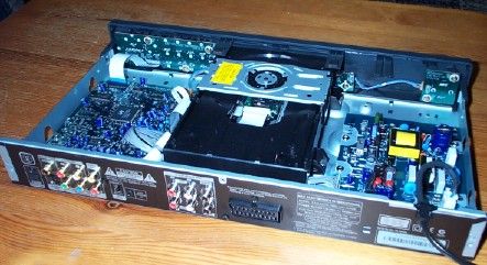

Silver Member Username: GhiacabrioletNC Post Number: 117 Registered: Apr-04 | Hello Gentlemen, I hope I'm not hijacking this thread by asking this question. If so, just let me know and I'll start a separate thread. Above some details were provided regarding recording LP's to computer to burn to CD. I'm looking for solution to do this for DVD-A and SACD (that don't have hybrid/redbook track). I want to be able to take recordings that I only have in DVD-A/SACD format and "rip" them to my computer so I'll be able to download to iPod - thus, I don't care about whether multichannel is retained, etc. Is there a solution available for Mac PowerBooks? If so, would it be software solution or does it require interfacing the mac with the audio equipment? Thanks! |
Gold Member Username: John_aPost Number: 1240 Registered: Dec-03 | Hello Ghia, Welcome! just to say there seem to be pop-up ads and others around for "ripping" DVD-As. SOrry not to be more specific. You will find them. You will not be able to avoid them! Our PowerBooks will not play SACD/DVD-A, so naturally you will have to connect to an SACD/DVD-A player to get an input. They will, however, play DVD-V and the Cd layer of hybrids. I f you are going to down-sample as far as normal MP3 and AAC files, it will make no difference at all if you start with the sources you can play on a Powerbook. BTW I am an iPod fan. too. You can get CD-quality if you are OK with no more than about 15 CDs on a 10 GB disc. Why any one wants hundred or thousands, with all the loss of quality that entails, is a mystery to me, but that is me. You can over-write and replace stuff you've listened to in seconds, through the FireWire link. |
Silver Member Username: GhiacabrioletNC Post Number: 121 Registered: Apr-04 | JohnA I agree with your assessment about the mystery of carrying thousands of low-quality files on iPod. I have the iPod Mini so the capacity is 4gb. My files are ripped 320kbps AAC and I can usually get around 400 songs to take with me which is more than enough. That quality through the headphones is sufficient for me. I love the smart lists that allow me to cycle my way through my music library as I sync the iPod with iTunes. This truly has exposed me to some long lost songs as well as songs I never gave a good listen years ago. DVD-A will play on PowerBook. Right now, I've got kd lang's "invincible summer" playing on the PB as I type this and earlier I tested Buena Vista Social Club and found it worked too. It brings up the DVD Player but not iTunes. Hence the problem. SACD only throws an error but the hybrid obviously works. Since I've got "pop-up ads" blocked in Safari, it looks like I'll need to do a google search on how to do the ripping. Maybe there's some info up on the Apple boards too. Thanks! |
Silver Member Username: GhiacabrioletNC Post Number: 124 Registered: Apr-04 | For those interested, I found a way to rip DVD-A to Mac computers: 1. Use MacTheRipper to get the files off the DVD-A 2. Use bbDEMUX to separate the video and audio streams 3. Use bd4go to convert .ac3 to .aiff All the above steps worked. The only problem I've run in to, and it is a major problem, is no sound is coming out of the .aiff. I'm investigating this. |
Silver Member Username: GhiacabrioletNC Post Number: 125 Registered: Apr-04 | The steps in the last post don't seem to be the "definitive" answer. It appears the results may vary from recording to recording (sort of like stereo/multichannel, eh John?). First, instead of using MacTheRipper I'm using OSEx which allows you to get more granular on what you are extracting. Using it and bd4go allowed me to extract audio from one DVD-A but this did not work on a different DVD-A. And, OSEx doesn't seem to recognize DTS at all. I'll keep working at it and, if I find some consistency, I'll report back the detail steps - assuming y'all are interested? I think I'll start a new thread about this topic on the Home Audio DVD-A forum as that seems to be a more appropriate place for it. |

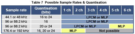

Gold Member Username: John_aPost Number: 1266 Registered: Dec-03 | Gerrit, Arno, My understanding is that MLP is allowed, not required, for DVD-A. It is "Meridian Lossless Packing", that is, a way of decreasing file sizes in order to get more on the disc, without affecting sound quality in any way. MLP is the only permitted way of doing that, but it is still only an option. Linear PCM without MLP will sound just the same, and still count as "DVD-A". See links in my post above of May 24. When buying discs, just choosing "Format: DVD-A" should be enough. In practice, all DVD-A discs also have DTS 5.1 and/or Dolby AC-3 on a DVD-V partition, in order for them to play on DVD-V-only players, too. |
EJ Unregistered guest | John, I am still assessing the DVD-A authoring software to buy. My understanding is that the Minnetonka's discwelder bronze is incompatible with MLP, it supports Linear PCM. Are you saying that there is no discerning difference in sound quality in both formats? Excuse my ignorance as I am not a technical person, if MLP is a way of decreasing file sizes in order to get more on the disc without affecting sound quality, how does Linear PCM operate and compare in respect of this area. I have visited the web sites you have drawn my attention to but I still have not come across any other DVD-A authoring software which I consider as a good option to purchase. Do you or anyone who have experience using any brand of DVD-A authoring software and could recommend its purchase? |
Gerrit Unregistered guest | John, As far as I know.. Without MLP the sampling rate of the DVD-A cannot exceed 48Khz for a multichannel recording and still fit into the DVD data bandwith. The biggest benefit of DVD-A is 24/96 through 5.1 Channels. This can only be done via MLP. EJ For 2channel the LPCM stream at 24/96 will have no deference from a MLP packaged stream except for file size. Some sources also claim that "MLP also features radically improved data validation techniques to ensure that the signal, as delivered on the DVD-A, is identical to the master signal." How much of this is hype or truth?? Gerrit |
Gold Member Username: John_aPost Number: 1267 Registered: Dec-03 | EJ, My guess is that MLP is proprietory. It was developed by Meridian, and licenced, in some way with the agreement of Dolby, as the only allowed "compression" for DVD-A. I mean "compression" in the computer sense, not the audio (Dolby) sense. Everyone seems to agree that MLP is lossless, that is, the LPCM you get out after unpacking is identical to the LPCM you packed in. So you can compare MLP with binhex, zip, tar, and sit compression formats for computer files; the original is still in there, waiting to be unpacked. And you can transfer such files faster, or in the same time over narrower-band connections, without loss of data. Gerritt, I have checked; you are correct the sampling frequency limit without MLP for 2-channel is 96 kHz; with MLP it doubles to 192 kHz, and this is because of the data transfer rate (aka bandwidth). It is important to distinguish between the sampling frequency and the sound frequency: the maximum analogue sound frequency you can get out of digital sampling is half the sampling frequency. So your figure of 48 kHz looks like the maximum sound frequency you can get from DVD-A without MLP; with MLP it goes up to 96 kHz. 48 kHz is still off-scale as regards anything that anyone can actually hear (up to 20 kHz), and most people's speakers only go to 20 kHz or a little beyond. So I am fairly sure there will be no audible benefit of missing out MLP; it is just a question of disc space. Everyone, I have taken the following from the excellent document from Disctronics, and paste in their tables 7 and 8. I hope they don't mind; their expertise is a good recommendation of their company. they are professionals who obviously know the formats inside out. Source, a pdf file "New Formats for Music: DVD & SACD" from: Meridian Lossless Packing To increase the playing time of a DVD-Audio disc to at least 74 minutes per layer for the highest quality and to allow the highest quality for stereo, WG4 has chosen Meridian Lossless Packing (MLP), also referred to as Packed PCM (PPCM). MLP is easy to implement and will not alter the decoded signal in any way. Decoding MLP requires relatively little computing power even for six channels of 24-bit/96 kHz audio. But how important is MLP? DVD-Audio offers a maximum bit rate of 9.6Mb/s, higher than the 6.144Mb/s possible with DVD-Video but not high enough for 6 channels of 24-bit/96kHz audio, which would require a bit rate of 13.8 Mb/s. Using MLP reduces the bit rate to less than half this and increases the playing time from 65 minutes to at least 74 minutes and allows room for extras such as still images, menus, text and video. MLP provides many more features including the possibility to choose the quantisation in one-bit steps. The possible sampling rates, quantisation and numbers of channels for both PCM and MLP audio are shown in Table 7. ![]() Examples of typical playback times with MLP are shown in Table 8 for high quality stereo, high quality surround sound and CD quality stereo. ![]() |
