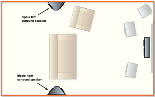

also what is the best position for surrounds. i always thought on side or behind the listener but just glanced thru my marantz manual and it said slightly in front which i found strange.

I like bipoles for surrounds. (I have no experience with dipoles.) I would stick with the Warfedales for best tonal match with the fronts.
Placement with bipoles should be about even with the listening position, and about 3 to 4 feet above ear level.
