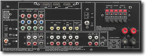

ok im going to try to hook up the ps3 to AV receiver then AV receiver to TV here is the model number of my receiver
yamaha (this the back)
RX-V363BL Upload
Username: Onecall
Spokane, WA
Post Number: 43
Registered: Dec-08
Scott,
According to the manual for your reciever you'll have to make a separate digital audio connection along with the HDMI. Your receiver will not pickup the audio from an HDMI input.
With you PS3 you'll need to use an Optical Digital cable.
Matt @ OneCall
