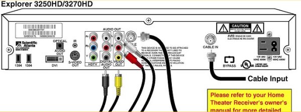

I attached the diagram of the back of my cable box, you can see where it says "Digital Audio Out". What type of connection is this?
Username: Project6
Post Number: 12681
Registered: Dec-03
You have analog left and right audio output as indicated by the red and white jacks. This is not digital.
You also have an optical audio output. You will need a toslink cable also known as optical audio cable to connect to your receiver (if so equipped)
You also have a digital coaxial output, indicated by the gray colored jack. Your receiver, if equipped with this input is usually color coded orange.
