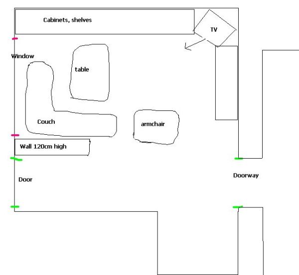

Hello. I just ordered my very first HT set the Sony 6.1 HT-DDW880. And just now started looking around in my livingroom... and I'm lost.
I made a quick mock-up of the room to show you the layout. The room is about 20square meters or so.
The biggest concern is, that I can't really move anything out of place. The only thing I CAN do, is move the sofa out of the corner a bit, but n omore than 1 meter(about 3 feet or so). (women trouble ) So what would you do if you guys were in my shoes?

First question, are the cabinets/shelves too high to put speakers on?
If not put your front two either side of your TV or will they fit in the shelves?
Your center front will go on top of your TV.
your sub might work in the corner behind the couch, a lot of cable to get it back their though. The only other place it looks like you have a spot is on the end of the vertical shelves, a bit out of the way though.
With your real speakers and your L-couch you'd probably best with you center in the corner of the wall and 120cm wall. Left rear on the end of the 120cm wall and right rear on the other purple mark.
It's a tough room, good luck.

Thanks for your input. And no, there is no problem with the main speakers and center one as they will fit nicely as you sugested. But the biggest issue is with the 5th surround speaker. the one that has to go directly behind you. If I put it in the corner of the wall and 120cm wall, it will be as close as 1-2feet from my head. Isn't that a little too close? Can I put it up higher on the wall to get some distance? and if I do put it higher, do I need to direct it?
