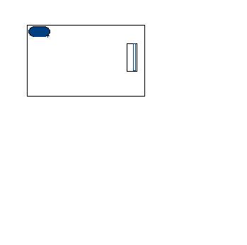

I have 5.1 Creative speaker system. And my computer is located in the corner ( Bluse colored) of room of 20*16 Feet . As shown in picture. Sofa is also shown in figure. So how I should arrange my speakers? Other furniture (Show case) is on opposite side of the computer. and Windows is in the front of the Sofa near to compter. So this is the only place where I can keep my computer.
Thanks and Regards,
Sameer Upload

Username: Project6
Post Number: 9004
Registered: Dec-03
Experiment sameer. You really can't do much for computer speakers when you try to turn them into a home theater speakers.
