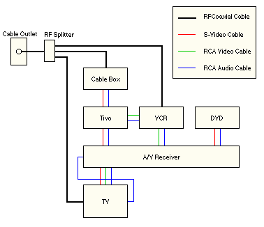

Username: Victory1
I basically need this set-up without the receiver. How do I modify it? And of course the Motorola Digital cable box is driving me crazy because the RF Coaxials are both RF IN & CABLE IN.

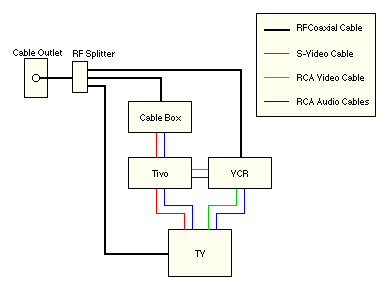

Username: Victory1
I found another one without the receiver but the DVD is missing. If it's easier, just tell me how to add the DVD Recorder.
