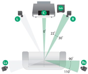

Dolby suggests this as ideal:
This, with the surrounds slightly above ear level. As FEOT suggests, compensation for any different distance could be made via different volume settings for the rears. Also many AVRs have some sort of digital distance compensation configuration for all speakers in their surround setup procedure.
