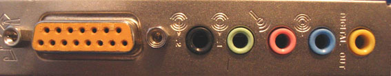

Ok, my mistake, Speakers don't have digital in, but you can see attach and there is digital out on my sound card (yellow), so what you mean when you said it can't support 5.1? I searched and find Creative Inspire GD580 and it said that can be used on my card for 5.1 sound?

Obviously it has a digital out, so what you will need to do is get a mono 3 millimeter phono to rca converter here:
http://www.radioshack.com/product.asp?catalog%5Fname=CTLG&category%5Fname=CTLG%5 F007%5F002%5F003%5F008&product%5Fid=42%2D2444
and plug it between the coax digital in on the Creative Inspire GD580 and the output on the soundcard.

Username: Daedilus
Post Number: 97
Registered: Jun-05
Some 5.1 sound cards have 5 channel speaker level outputs, most have digital 5.1 out only, like yours. so you will have to buy a 5.1 speaker system with a DTS decoder like the Creative Inspire GD580

Not so, Monologue. On some cards, Audigy in particular, the digital output has a switchable mode between analog or digital duty.
if you set it to analog it becomes a speaker level output for center and subwoofer. just use a stereo 3 mm plug.
http://files.americas.creative.com/manualdn/Manuals/TSD/7299/Audigy.pdf
Its on manual page A-3

Doh, my nut, was thinking line out and wrote speaker out. Yes, it must them pulg into your 5.1 system sub with integral amp

Aha, Thank you, and one more question, is it better to use digital out instead 5 channel speaker level output?If you could explain it to me...(i'm new so that's why i am asking this)

no speaker level output only line level.
Your 5.1 systems subwoofer has the line level inputs and an amplifier built inside it.
The line level outputs 5.1 plug into your subwoofers Line level inputs.
The amplifier in the subwoofer then amplifies it and sends it out to the speakers.
The Line level outputs only have sufficient power to run a set of headphones
plug the stereo 3 mm to rca converter cable in as described in picture 2-2 of this manual:
http://files.americas.creative.com/manualdn/Manuals/TSD/7639/Creative%20Inspire%20GD580%20Users%20Guide%20English.pdf

I am not asking for GD580, I am asking that becouse i want know, is it better to by speakers with decoder like this or some standard 5.1 (wich one sound is better, speaker with decoder or analog speakers), and i know that i can't connect analog on my SB, so i am asking maybe to by new sound card.

Either is fine, if your 5.1 speakers are set up to receive the line level out from the sound card then they are fine.
The digital should only be used if you need a system that has a seperate decoder/receiver to adjust levels or volumes individualy.
Either type is fine. The only reason a seperate digital decoder would help you is that you are paying more money for it so it is probably a better speaker system as well.

Aha, but I have sound card that support digital out and not 5 channel speaker level output (look up), so I should by sound card that support 5 channel speaker level output out so I can by and speakers without decoder.

Username: Daedilus
Post Number: 112
Registered: Jun-05
This will be my last post on this thread.
You cannot, anywhere, for any price, not if you where the Majhal of istanbul, buy a 5.1 card with speaker level output.
They are NOT made.
Bill Gates cant buy one, hes not rich enough.
Either Buy 5.1 speakers that support digital in or 5.1 speakers that use line level in.
If your current card has digital out then it makes sense to buy speakers that match it, so you dont have to replace it also.
