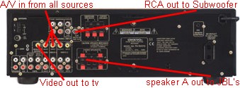

Nix_Vet, try this:
Hook your av cables to your receiver, not to your tv. also hook your active sub up RCA to the receivers subwoofer output instead of speaker level.
hook your JBL's directly to speaker A outputs, not through the Sub.
Run composite video from all of your components, (Dvd, Vcr, Cable, Sat etc) into the A/V inputs on the receiver and run monitor out from your receiver to Vid 1 input on your Tv.
If you want to be able to watch tv without the system being on, you can run the RF out of the cable box to the tv and switch between channel 3 for no theater or input 1 for theater.
Username: Nixvet
Registered: Jun-05
Thanks Michael!
I hooked up everything as you showed. Much better sound. Now I can take advantage of my system and the digital cable. Truer bass, crisp highs...now I just need 2 rear spkrs and a HiDef T.V.
