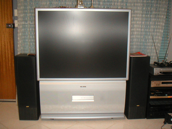

Hi, I'm just worried about placing large speakers next to a TV. I currently place my speakers right next to my tv, and im scared that it would ruin my tv. Would any1 be able to give me some guidelines on how to place my speakers, or would you be able to tell me if the current arrangement of me speaker is alrite or needs some improvement? I have attached an image of my current arrangements. My speakers are Jamo 120W and my tv is a Toshiba rear projection.

Placement ok if speakers are shielded.

how do i know if the speakers are shielded?

If your tv picture is distorted and/or has strange colors along the sides where the speakers are located, they are not shielded. You could also refer to your owner's manual if available.

I aloso agree with the above --if you are not getting any interference then you are ok

I do not see any picture or color distortion with this tv, but i had an older tv, just a normal CRT, and it had colour distortion when the speakers are next to the tv. Would this affect my current tv in the future or sumthin?

Sounds like the speakers are unshielded. I'm not a technician but seems like I read somewhere that using unshielded speakers in close proximity to the tv can have an adverse affect over the long haul. Basically, you have magnets pulling on the metal parts of the picture producing apparatus. Send an email to David Massey. He seems to have great technical knowledge. As for me, I would relocate the speakers away from the set.

who is David Massey? and whats his email? And also, would it be ok if i placed a sheet of mild steel between the speakers and the tv, so it would insulate out the most of the magnetic field, would that solve the problem in any way?
