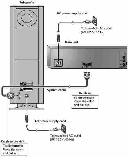

Could I use the SB-WA310 active subwoofer (and connected surround speakers) that came with this Panasonic system with another amplifier? I'm not sure how to work this in with the special system cable (K1HA25HA0001) connection to the subwoofer. You can slightly see on the diagram schematic of this system with system cable attached below (more fully seen in the owner manual linked above) that all the other front/rear/center speakers also attach to the back of the subwoofer. The system cable inlet on the subwoofer, the sole audio signal inlet, consists of a 3 cm x 0.5 cm, 25 pin (female) receptacle, with twelve holes in line next to 13 holes in line. The subwoofer is amped by a 120 V chord. Specs on the subwoofer follow:

The system cable is a big problem for you on reusing the sub, the sats, at 6 ohms could be used but with that cable acting as an SR link to the sub, your pretty much toast without it.
I would just buy a new receiver.
