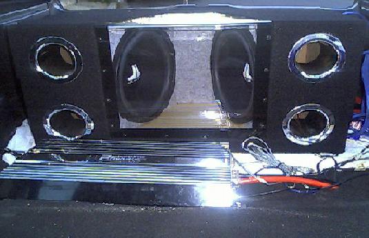

HELP ME!!!!!!!!!!!!!!!!!!!!!!! 2 w3's and 1200 watt amp, dont know how to wire it, please help me
Username: Bigpimpin650
San francisco
Registered: Aug-04
HELP ME!!!!!!!!!!!!!!!!!!!!!!! 2 w3's and 1200 watt amp, dont know how to wire it, please help meUpload
Username: Toddyboy
Registered: Sep-04
4 gauge red from battery to fuse block to amp 4 gauge black to good ground blue remote wire off the back off the deck to the remote turn on then rcas from deck to amp then speaker wires from amp to subs hope this helps keep it loud
