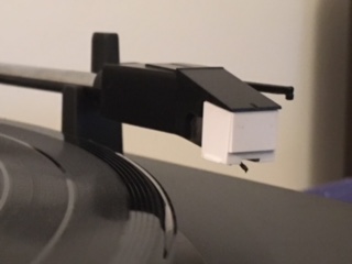

I've taken a picture of the stylus/cartridge. As I said, I'm a novice when it comes to this stuff so please let me know if it does indeed look broken to you.

You can't tell by such a photo. You would need to inspect the cantilever's end under a microscope. If you touch the end of the cantilever, even if the stylus tip is gone, you'll feel the pipe and assume the tip is still there. Do you have a microscope handy?
There are other alternatives but they are far less likely to be a cause of your problem. If you have another table, you can try it with your amp. Or you could hook your turntable up to another amplifier - with a known to be working phono section.
