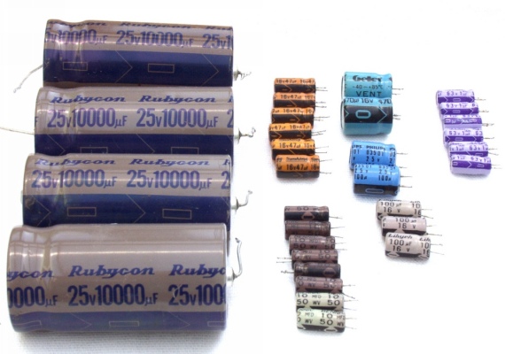

About the capacitors of the amplifier, I have seen a photo of that device inside and I could count about 60. But there are specially 4 great units that are of the power supply that have a value of 10.000 microfaradios - 25 V of the brand Rubycon.
I think it would be a good idea to change those 4 units...
And also check the input selector switch to prevent contact failure because sometimes the sound of a channel disappears.

Here are all the capacitors of the A1:

YIKES!
OK, caps do not require replacement unless they have failed or show signs they are beginning to fail.
Did you do any checks or measurements on this amp before you tore it apart?
Each part in an amplifier has what are termed "tolerances".
Manufacturers tend not to buy the tightest toleranced parts unless they feel a specific part might benefit from a 1% part vs a 5%. "High end" electronics tend to use more closely spec'd parts than will the mass market builders.
Some high end builders will hand check parts for even tighter tolerances to meet critical design objectives.
By replacing parts willy-nilly you may risk throwing off a circuit which, in total, meets factory specs.
Power supply caps are large and, therefore, tight tolerances are expensive, and for the most part, unnecessary. Filter caps are out of the signal path and do not affect the sound quality of the component. Storage caps are not directly tied to the signal path either. Coupling caps in the main circuit of the amp are also out of the signal path. Swapping out these caps is probably money and time wasted unless they are failing.
There has been an argument for and against the "sound" of caps that has run over the last thirty years in high end audio. High end builders/designers tend to select caps and resistors based on what they perceive as the most desirable musical performance at the most realistic cost.
You can select from Mylar, poly or paper in oil caps (to name a few options) and somewhat alter the perceived performance of an audio component. Only you can decide whether the change is worth the cost.
Resistors have similar characteristics. Output devices set the final "sound" for any amplifier.
IMO it's not the best idea to just rip an amp apart. If the amp was operating at its OEM specs, then you've not thought through what you want and where to go to find it.
If you don't know whether the amp was operating as designed, then you may replace parts but still not know why the amp needs work.
It's sorta like thinking you want a new car because the old one hasn't been running right so you go buy tires for your old car.
Good luck.

PS caps, the BIG ONES should be replaced at First Sign of a 'bulge'.
Waiting until they 'pop' is dangerous and destructive. Such caps can last 25 to 30 years in regular service and Less time when stored than slammed with just bein g turned 'on'.
Having your tech adjust the bias is a fairly simple procedure needing only knowledge of the test points, the value needed and the location of the little screwdriver potentiometers. It might be worth 1 hour of his time to adjust back to spec and just look the amp over for any obvious defects or problems.
