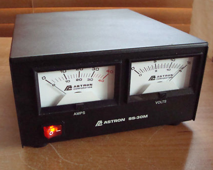

A MUCH better 12vdc source is NOT a battery and charger, but a dedicated 12v DC power supply from the likes of Tenma or Astron. These do get pricey when you go over 30A, but are much safer and much easier to use. They go up to 70A which is more than sufficient to power MANY of the bigger car amplifiers (and you get a nice amperage+voltage meter on many of them):
ebay is the best place to grab these. Typically there is a negative and positive terminal on the back and that's it. Simple. The above unit is on ebay and will sell for a little under $100. The 70A units are $300ish.

That's another way to go. But, first, the op stated he didn't want to spend money. To me that means either way he powers the amp is not going to fit into his scheme. Second, I suspect at that price range the power supply you show is a switching type? That would be OK for driving a subwoofer but less than great for anything above 100Hz when driving the typical car amplifier. His amp still won't develop the stated wattage when driving a simple eight Ohm - or even a four Ohm - load when driven from your power supply.
Safer? I don't see any safety issues with either power source. The SLA's are fine in a home environment and are used by a good number of listeners who use T-amps or other chip amps - myself included when I use my T-amp. Either way, you make a single connection between power source and the amp, nothing fancy and certainly nothing dangerous. Either way you have this fairly large box running the amplifier.
The more conventional power supply can - at a cost - supply higher current capacity than will a SLA supply but now we're talking about how to spend $400 and the op would do much better putting that amount into real home audio gear IMO.

Jan, that is true about anything in the higher frequencies: with the switching power supply there is a minimal amount of hum above 300Hz when the volume is low. But since the OP is using this for a subwoofer application, it's not as big of a deal.
I suppose it's more safe in the sense that you don't have to continually hook up the power wires to a charger.
Though at $100 vs. the $200 option of the battery and charger, and trying to save money, the power supply fit his needs better.
But really, as James said. The bottom line is spending money on some home audio gear is the better way to go. A nice home subwoofer can be had for 100-200$, especially with using ebay or craigslist.
