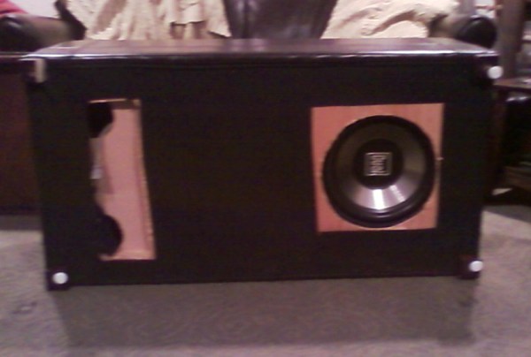

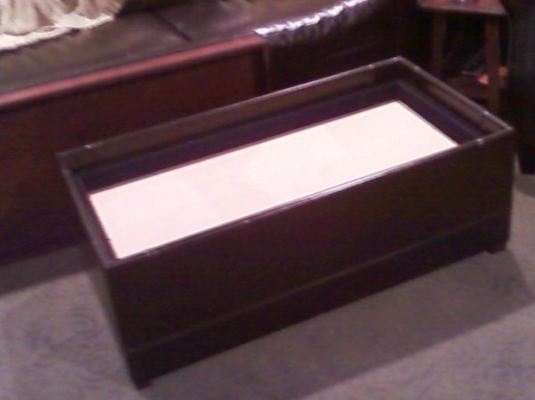

New member Username: The_madmanPost Number: 4 Registered: Mar-10 | On the cheap. I like it. Make it happen Cap'n ! If you fail , then you learned something , if you succeed , then you learned something ! WIN ! I did it ! I built SubZilla !The backstory is , I have a Yamaha HTIB and the sub was dissappointing. So I take an old 165W car amplifier , 500W computer power supply and the Sub output from the Yamaha , add them to a 12in cheap subwoofer in a 3cu ft ported MDF box. All components go in the box , add power cord and drop the works into an existing ottoman in the livingroom and BOOOM ! Instant incredible floor shaking sub. If I were to buy all the components Id be in for less than $200 , save for the Ottoman. $50 amp , $30 12 in Woofer , $30 500W P/S , One sheet 3/4 MDF $30 , one "Y" cable to separate the signal from mono to stereo for the amp input. Oh , and I opened up the bottom of the Ottoman to let the sound out. Yes, cheap. Yes bragging. YES incredible booming sound.! ![]() ![]() ![]() |

New member Username: The_madmanPost Number: 5 Registered: Mar-10 | Thank you Leo. It truly was an experiment that payed off. Now that the gears are whirring in my head , Ive added an "AudioEngine" wireless to get rid of the RCA cable ($99), and am considering going with a Pyle 75W rackmount amp to replace the 120V to 12V experimental model.. The THD is less than the plate amps typically are and pretty darn cheap too , at around $60. A Better woofer is also in the plan , but off in the future. I'll see how long this config lasts. I have to say that I tested this on "Iron Man" and it was truly amazing. I felt every punch , blast off and explosion with explicit detail. As for music, Im not trying to kid anyone that the sound quality is anything near great. One system is definately not like the other. |
Silver Member Username: MagfanUSA Post Number: 984 Registered: Oct-07 | I don't know how important distortion is a very low frequencies in movies. I suspect the ear could tolerate up to 10% without even noticing. Also, a 500 watt computer power supply may only put 200 watts to the 12v outputs. And than it may be divided up? I don't know, but to see if you get more / better out of your rig, try a car battery for a few minutes. That will have unlimited power, given your situation. Be careful, car batteries are pretty dirty most of the time. Got a meter? RatShack sells a few for cheap....try taking some measurements of the power supply and voltage drop from loaded to unloaded. If you can measure the current, so much the better. And you're right, this wouldn't satisfy for music. Keep an eye on the budget, too. |
New member Username: The_madmanPost Number: 6 Registered: Mar-10 | Thanks for the advice ! I happen to be a "meter" kind of guy. The amp draws at maximum 5.63A@12.5VDC. From the power supply. Thats just 75 watts. I ran it for 2 full feature films and never had an overheat problem or a significant voltage drop. Like mentioned before , Im going to play "wait and see" to discover just how reliable this setup might be. It was great to play with an idea and see it come alive. When talking about distortion , i suppose I meant "clipping". Driving the speaker beyond the capability of the plate amp or speaker itself was the issue . Hence the direction to the " bigger must be better" SubZilla. Thanks again for the offer of your obvious wealth of experience. |
