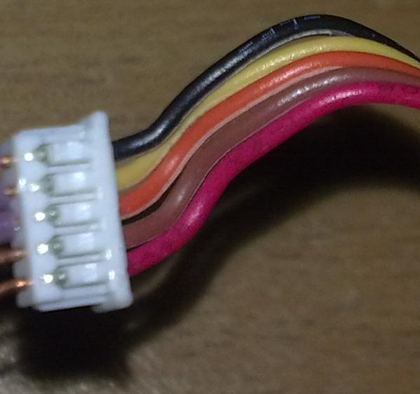

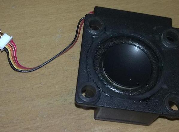

Hi this is my subwoofer was woundering how to connect them as in which wire is for wht?
RED
BROWN
ORANGE
YELLOW
BLACK

That's what? A three inch subwoofer?
Obviously the connector is meant to plug into a specific component? Why are you asking which wire to use if you have a plug that only fits in one direction? Are you trying to make this something it is not?

just wanted to know if u guys know whts the meaning of the colors?
its a 1in subwoofer i am trying to connect to my soundcard...this is completey for knowledge i know it wount make much difference in sound quality but just for knowledge?

For knowledge, use a meter to measure the resistance of each conductor and see if there are dual coils or a feedback circuit.
Repeat the test on diode, this may indicate a feedback loop.

Black is typically ground and red is normally hot. Beyond that it is the preference of the manufacturer to decide which color goes where.

JS, if you want to learn, then use a multimeter, set on resistance (ohms) and measure the resistance between the various leads.
As you read the instruction manual, you will see that an ohmmeter is never meant to be used in a live circuit, so this test is performed with the driver unattached to anything.
You are looking for a value between 4-50 ohms, indicating continuity firstly, the exact value secondly.
There may be 2 seperate circuits indicating a value.
Keep notes on values as you measure.
Again, this is done with the driver on a work surface and no power, except the battery in the meter. You are very safe.
